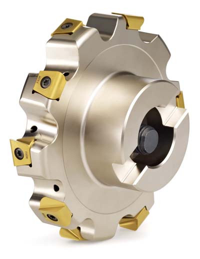

Seco Tools offers the new 335.25 Disc Milling Cutter. Designed for large widths of cut of 1" (25mm), the 335.25 Disc Milling Cutter complements and extends Seco's range of disc milling solutions. The new tool's coated and hardened cutter body maximizes tool life, reliability and accuracy, and is available with integrated coolant holes.
Inserts developed for the cutter feature positive geometry edge preparation to reduce cutting forces and improve chip flow, while a built-in wiper flat maximizes surface finish. A full range of insert geometries and grades ensures easy and productive application to all types of material, and the tool provides a versatile and flexible option for wind power manufacturers.
