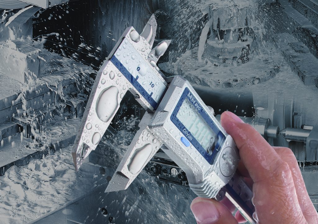

Product highlights include:
Incorporates Mitutoyo’s ABSOLUTE measurement system. No need to reset the origin.
The automatic power on/off shuts down the LCD after 20 minutes of inactivity, but the ABS scale origin is unaffected. Power is restored to the display when the slider is moved.
Can be integrated into statistical process control and measurement systems.
Larger LCD of 9mm, a 22% increase in height for improved visibility.
Extended battery life of 5 years has been achieved due to low-current integrated circuit.
Easy to operate with advanced ergonomic design that uses only one button.
Battery cap does not require a screw driver for simplified battery replacement.
Mitutoyo IP67 ABSOLUTE coolant-proof calipers can be used in workshop conditions exposed to coolant,
water, dust or oil. 100% air-leak test ensures every caliper conforms to IP67.
