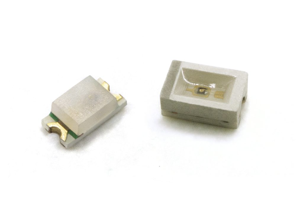

597 SMD Series of LED Indicators
Dialight announced the launch of a new 597 SMD series of LED indicators. The four new indicators offer tighter intensity binning, reduced light bleed, and electrostatic discharge (ESD) protection for high-performance electronics, networking and control panel applications.
August 7, 2018
“These new products are a clear indication of Dialight’s dedication to innovation and responding to our customers’ needs,” said Dialight Vice President of Signals and Components Matthew Boudiette. “And, because of our 80-year history in the indicator business, customers know they can count on us for the dependability, reliability and value they need to fit every application.”
The new 597 SMD products include:
  • 0603 Tighter Intensity Binning Series for greater product intensity uniformity and better consistency. Offering two intensity bins max on green, blue and white LEDs and one intensity bin max on red, red-orange, orange, yellow and yellow-green, this series enhances design aesthetics with improved panel and display uniformity.
  • 0603 Domed Lens Series with a 60-degree viewing angle, ideal for light pipe applications. The Domed Lens series’ narrow viewing angle reduces light bleed in applications utilizing multiple OptopipeÒ light pipes and offers increased on-axis intensity versus non-domed products of the same size. The Domed Series is available in seven colors.
  • 0805 Reflector Cup Series with a 110-degree viewing angle. The built-in reflector cup projects light wider for better visibility while reducing bleed in light pipe applications and on front panel displays. The 0805 Reflector Cup Series is available in nine colors.
  • 0603, 0606, 0805, 1206 Series with integrated Zener Diodefor superior ESD protection. Ideal for handheld and portable equipment, ID tags and other movable applications that are at risk of ESD exposure, the ZD Series ensures a more reliable, longer-lasting and more resilient product for end users. The built-in transient voltage suppressor provides Human Body Model Class 2 ESD protection for up to 4,000 volts – the standard for manufacturing and most finished products. This Series guards against both instant, catastrophic failure caused by ESD, as well as minor ESD damage that causes performance degradation over time.
