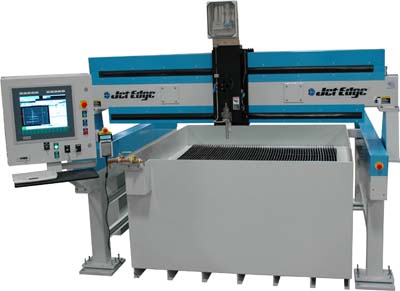

5’x5′ Mid-Rail Gantry Waterjet
Jet Edge's 5'x5' mid-rail gantry waterjet cutting system is powered by a 60,000- or 90,000-psi waterjet intensifier pump, available in 30- to 200-hp models.
June 1, 2010
Jet Edge’s 5’x5′ mid-rail gantry waterjet cutting system is powered by a 60,000- or 90,000-psi waterjet intensifier pump, available in 30- to 200-hp models. The machine has an exposed 72″x72″ tank, which accommodates overhead loading and cuts materials up to 60″x60″. An optional second cutting head permits waterjetting two parts up to 30″x60″. The machine can be configured so all three axes are fully programmable (Z-axis is optional).
