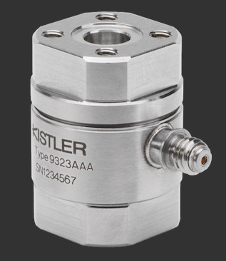

The new 9323AAA compact force sensor from Kistler: the key to measuring extremely small forces of under 5 N. For manufacturers and suppliers of components for the automotive industry, semiconductors, electrical equipment and medtech devices, this sensor guarantees reliable processing of the very smallest parts.
