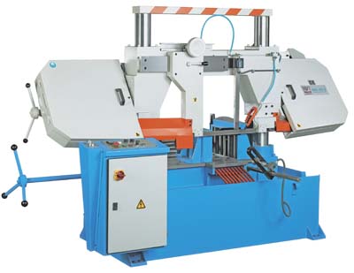

Knuth Machine Tools USA Inc. carries a variety of machines, including high performance bandsaws with automatic feed. The ABS 320C is a fully automated bandsaw with a twin column guide system.
July 1, 2010
Knuth Machine Tools USA Inc. carries a variety of machines, including high performance bandsaws with automatic feed. The ABS 320C is a fully automated bandsaw with a twin column guide system. The automatic feed system utilizes a powered pinch roller system with ¾ horsepower hydraulic motor for automated, rapid material advancement. Designed with a limit switch to cut lengths accurately, this machine also comes equipped with a programmable part counter for exact productivity and lower material waste, and an automatic height adjustment to limit space between the blade and the material, so no time is wasted cutting air. The saw frame feed has an infinitely variable cutting speed from 65 to 330 feet per minute and a main motor drive rating of 5 horsepower provides for sufficient power reserves. There is also rigid, dual column guide for parallel cuts, a torque-resistant weldment, and a cutting capacity of 13.75 inches by 12.5 inches. The ABS 320C uses new helical gears and a hydraulic cylinder. These gears ensure exceptional quality service, a longer life-span and lower overall maintenance, while the large cylinder dimensions ensure continuous consistent and quiet operation. Plus, the machine incorporates an automatic shut-down when the blade breaks for added safety and productivity. Standard equipment includes a coolant system with 3 nozzles, a saw blade cleaner brush, a 48 inch feed roller table with linear stop, and an operator's manual.
