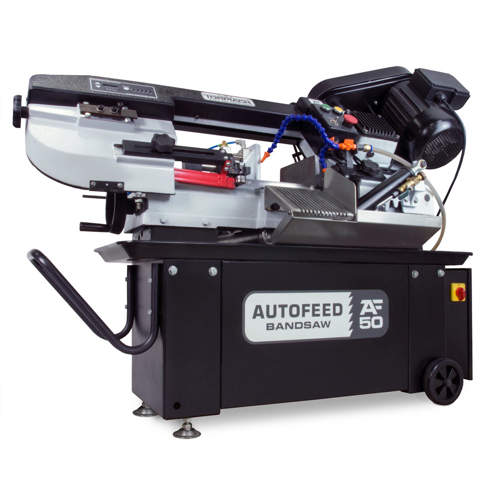

Features include:
■ Pneumatic Clamping System
■ Hydraulic Feed Control
■ Programmable Automatic Workpiece; Positioning Accommodates Cut Lengths between 0.157″-50″
• Up to 10″ per stroke
• Maximum five strokes (50″) per cut
• Maximum 999 strokes per program
• Stroke countdown display
■ Integrated Coolant System (2.3 gallon capacity)
■ 4 Blade Speeds
■ Blade Tensioning System
■ Portable
Specifications:
■ Capacity: 7″ round at 90°; 6″ x 8″ flat at 90°
■ Blade speeds: 135-161-226-394 fpm
■ Blade size: 93″ x 0.74″ x 0.035″
■ Feed control: Hydraulic adjustment
■ Vise: Pneumatic clamping
■ Motor: 1-hp 115-VAC single phase
■ Shipping weight: 385 lbs.
Dimensions:
■ Table Height: 21.75″
■ Length: 48″ + length of blade tension gauge
■ Width: 36″ (includes outfeed guide)
■ Height with saw at rest: 39″
Power Requirements:
