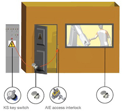

The AIE is a double key, stainless steel, access interlock suitable for machine guarding on hinged and sliding doors, gates and fences. The KS — power safe electrical switch is a key driven electrical switch suitable for the isolation or switching of low (20, 32, 63 or 150A) current. The key exchange units, such as X, Y, Z are for multiple access point machine guarding.
The trapped key interlock product line is extensive, providing solutions for both power interlocking and control circuit interlocking, machinery with different power sources, even pneumatic and hydraulic, machinery with fixed or variable run-down times, different environments, full access control (meaning a person can’t be locked in access areas if gate is shut because the machine’s key is needed to start the interlocking process), and robotic machine guarding (where access must be restricted to the end of a cycle products).
