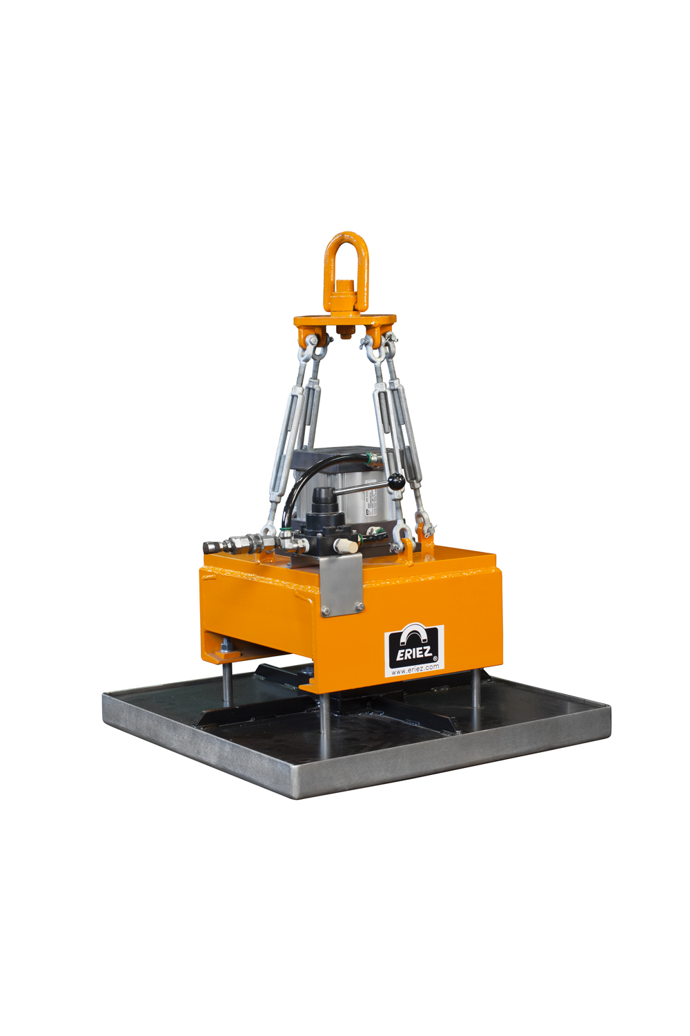

The new air-operated Burn Table Lift Magnet System from Eriez easily and quickly moves multiple parts or cut-outs up and off of burn tables. With a powerful magnetic circuit design, this advanced transfer system can also lift single sheets or plates up to 3" thick from a stack to load the table.
The new air-operated Burn Table Lift Magnet System from Eriezeasily and quickly moves multiple parts or cut-outs up and off of burn tables. With a powerful magnetic circuit design, this advanced transfer system can also lift single sheets or plates up to 3" thick from a stack to load the table.
Eriez' Burn Table Lift Magnet System improves productivity and creates a safer work environment by eliminating manual handling of multiple parts and the need for operators to climb on burn tables. This system can positively and significantly impact a company's bottom line through reduced labor and table downtime.
This new Burn Table Lift Magnet System features an innovative design with an extremely powerful and wide magnetic surface area. When activated, a stainless steel stripper pan retracts to engage the steel parts with a high magnetic holding force. To release, air cylinders push the stripper pan away from the magnetic head to create a gap and break the holding force.
Since Eriez' Burn Table Lift Magnet System utilizes permanent magnets and does not require a controller, there are no power failure concerns. Standard models include 24", 48" and 120" designs to accommodate most common plate or sheet sizes.
