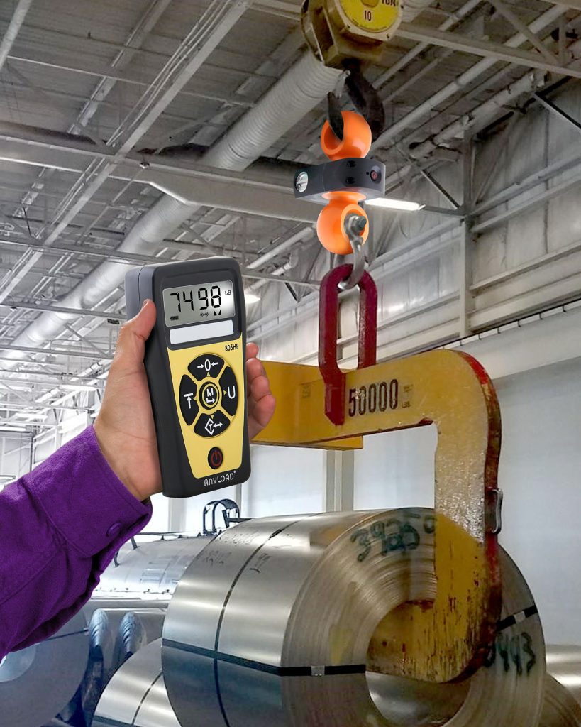

A new, dual-shackle dynamometer that has a 5 ton/100,000 lbs. capacity, is battery operated, and includes a wireless remote hand-held indicator has been introduced by Alliance Scale Inc.
December 5, 2018
The Alliance Anyload dual-shackle dynamometer measures only 6.5" vertically, has a 5 ton/10,000 lb. capacity and features a hand-held wireless remote indicator that operates up to 75 meters away. Simple to attach between a hoist and the load, it can perform check weighing for any load that gets picked up by a crane for instant weight verification.
Providing a maximum safety load 200 percent of full-scale, the Alliance Anyload dual-shackle dynamometer is manufactured from die-cast alloy steel and is designed to operate up to 100 hours on three AA batteries. The indicator has an ABS enclosure measuring 6.7" x 3.9" x 1.3" with a 0.7" 6-digit LCD display, uses four AA batteries and also operates for 100 hours.
