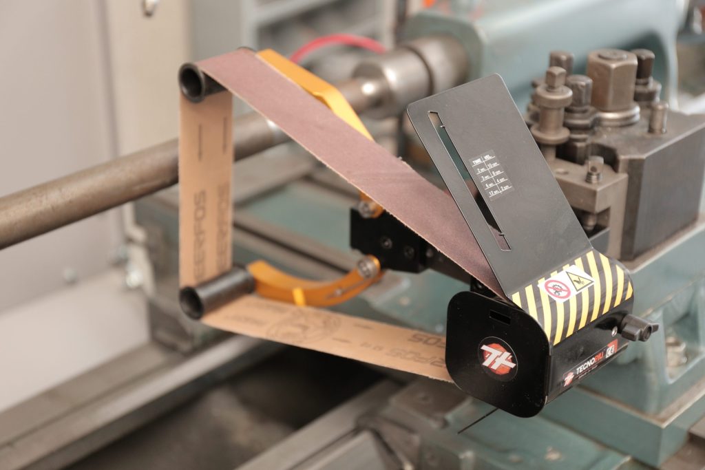

As part of its ongoing commitment to empower organizations to create safer work environments and comply with OSHA standards, Rockford Systems LLC has introduced an automatic sanding belt holder that enables lathe operators to sand, polish and deburr while keeping hands away from rotating parts and at safe operating distance away from the spinning shaft and, thereby, helping to prevent entanglement.

The lack of effective protection on industrial machines is a leading safety concern, ranking among the top 10 most frequently cited violations by OSHA, and one that puts thousands of operators at risk for catastrophic injuries. Metal lathes are dangerous machines that can cause serious injury. Of the lathe’s many dangers, the life-threatening hazard of entanglement can cause amputations, dismemberment and death. Entanglement is a risk whenever lathe operators use emery paper to sand or polish a rotating shaft. Without warning, the paper may wrap itself around the shaft, entangling the operator’s gloved hand, hair or loose clothing at over 1,000 rpm.
Simple to install and use, the belt holder fixes to conventional lathes’ existing tool-case turrets with the quick turn of a screw. An automated patented sliding system leverages the rotating movement of the workpiece, whether it is metal, alloy or wood, for precise results. Three unique opening positions enable the belt holder to sand machined parts of a wide variety of diameters to maximize its shop floor value while eliminating risk.
The belt holder is available in 25mm and 50mm width models. Both models can hold sanding belts of different sizes and abrasion grits (80/150/180/220/320) to satisfy a wide range of applications.
