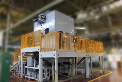

Mitsubishi Heavy Industries Ltd. (MHI) has developed a double-headed helical broaching machine, dubbed the “BH50-17,” capable of machining of a workpiece in 22 seconds. The BH50-17 also can perform simultaneous machining of two workpieces of different types at a time. The new unit incorporates advanced technologies of Federal Broach Holdings LLC, an American company MHI acquired in April 2012. By keeping the machine height to 5 meters, the BH50-17 achieves a compact size suitable for installation in standard factories in the Asian markets, including Japan. Going forward MHI will aggressively target global markets, with a focus on Asia and the home market, by supplying the BH50-17 together with broach cutters for use in the manufacture of helical ring gears. a type of internal gear used in applications including automotive transmission systems.
Helical broach machines are machine tools that perform machining of internal helical gears, i.e. ring-shaped gears with oblique tooth leads on the inner surfaces. The helical broach cutters, a long bar-shaped cutting tool, draws material out of a workpiece as it rotates, to form an oblique tooth leads.
The BH50-17 was developed to meet usage conditions in Japan and Asia based on a model that Federal Broach has already delivered in significant volumes primarily to the leading U.S. automakers. The adoption of 52-kilowatt (kW) high-power motors enables broaching at a rate of 25 tons per axis, while the adoption of a square (box) guide in the straight axis has enhanced mechanical rigidity and achieved high-speed, high-precision machining. The BH50-17 also features two servo motors that enable independent control of two tables, a configuration that permits simultaneous double-headed machining of two different workpieces. The achievement of a compact machine enables easy installation without a pit. The maintenance ease of the machine also has been enhanced through adoption of a crane for changing two different types of tool that enables smooth tool changes, as well as thorough cutting dust treatment, etc.
