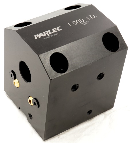

Parlec, a member of Techniks Tool Group, has release a line of made-in-USA BMT65 tool holders made from ductile iron.
According to Parlec, ductile iron has 6.6X the vibration damping properties of alloy steels enhancing cutting tool performance and extending tool life. Also, the higher graphite content of ductile iron reduces friction and prevents premature wear of the tool holder. Parlec BMT65 tool holders fit on many BMT65 lathe turrets including Haas, Doosan, Daewoo, Hwacheon, Hyundai, and others.
Parlec BMT65 tool holders are available in I.D. styles for 1”, 1-1/2” 25mm, and 40mm tool diameters for single-sided holders and in 1-1/4” for double-sided holders. O.D. style holders are available in 1” and 25mm for both single and double-sided setups.
