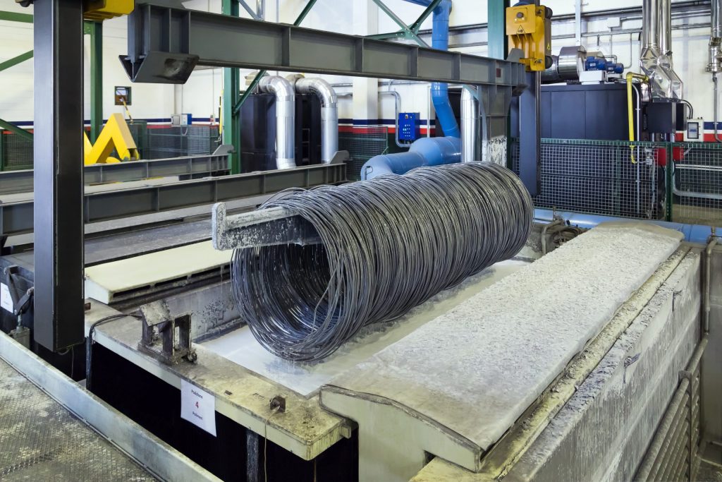

Bonderite L-FM FL is a nonreactive, water-based polymeric coating that enables a sustainable surface conversion process. Because the coating adheres to the surface physically without any reaction, the only evaporates produced in the subsequent drying step prior to cold deformation are aqueous. As a one-step process, Bonderite L-FM FL eliminates all rinsing steps, which saves water, and also has a reduced energy demand with appropriately lower CO₂ emissions. Furthermore, when the cold-formed screws are dephosphatized for final heat treatment, the polymeric coating is easier to remove, which permits the use of a dephosphating cleaner in much lower concentration, which means less consumption.
In addition to these environmental benefits, the Bonderite L-FM FL technology is characterized by its greatly reduced complexity over zinc phosphating. As a single-bath process, it minimizes equipment footprint and maintenance. Raw material surface properties require initial sand blasting or pickling and neutralizing, but the conversion cycle is essentially simplified to one single step and operates at a temperature between 40° C and 50° C, providing significant time and energy cost savings. Overall productivity is also enhanced by the excellent lubricity and pressure resistance of Bonderite L-FM FL in comparison with traditional zinc phosphating processes, which results in longer extrusion die life and has been confirmed in numerous industrial-scale applications.
