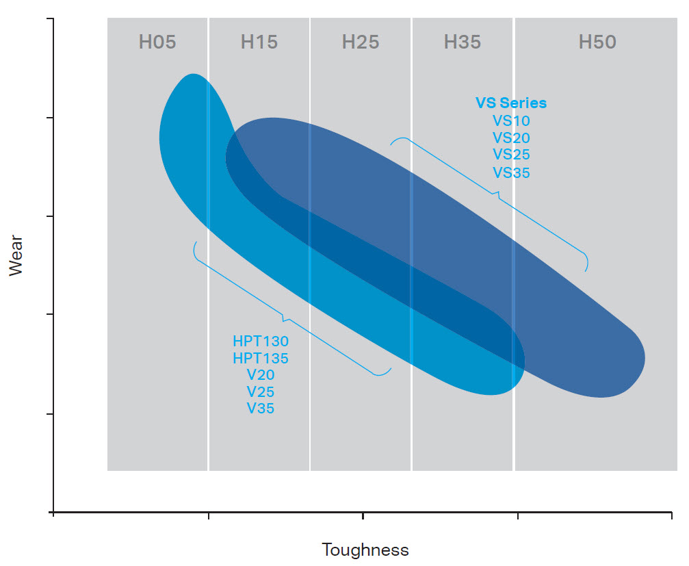

Sandvik Hyperion's BZN V-Series PCBN grades provide versatility in three key aspects of machining of hardened ferrous materials. First, the grades are able to work in case hardened, bearing steels, powder metal alloy steels, and tool steels.
September 26, 2016
Sandvik Hyperion’s BZN V-Series PCBN grades provide versatility in three key aspects of machining of hardened ferrous materials. First, the grades are able to work in case hardened, bearing steels, powder metal alloy steels, and tool steels. Second, they can be applied in applications such as turning, milling, and reaming. Third, a range of components can be machined, such as gears, shafts, bearings, CV joint components, valve seat components, and die/mould components. The BZN V-Series provides enhanced wear and fracture resistance, performance repeatability and uniform layer thickness.
The BZN VS-Series of PCBN grades complements the BZN V-Series and will offer significantly improved toughness while maintaining superior crater and abrasion resistance properties. The BZN VS-Series is made of solid PCBN, thus providing flexibility in tool design and geometry while eliminating the coefficient of thermal expansion mismatch often seen in carbide supported grades.
