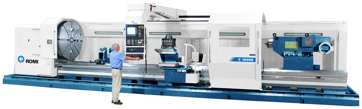

Romi C series heavy-duty flatbed CNC lathes are built with Romi made monoblock cast iron beds for optimal rigidity, accuracy and performance. The heavy-duty C Series includes nine models ranging from the C 1100H with a 28” (720 mm) swing over cross slide and 72-hp main motor, to the massive C 2600H with an 80” (2,030 mm) swing over cross slide, and a 155-hp main motor. All key components of Romi machine tools are designed and built in-house for complete control and assurance of manufacturing quality.
Romi’s line of heavy duty CNC lathes feature net weights ranging from approximately 39,700 lbs. (18,000 kg) to 134,500 lbs. (61,000 kg), maximum weight between centers from a generous 33,100 lbs (15,000 kg) to 110,200 lbs (50,000 kg), and maximum torque from 12,429 to 44,200 Nm.
The robust monoblock bed is made of gray cast iron and exhibits extreme rigidity. The cast iron headstock, also manufactured by Romi, features a spindle with Timken bearings.
Romi heavy-duty CNC lathes are powered by a high torque, continuously variable speed AC motor. The manually driven quill has a built-in live center with high precision bearings.
All models are built to reduce machine vibration and allow fast and accurate machining at full power. They are suitable for heavy applications in the mining, aerospace, steel mill and oil and gas industries.
