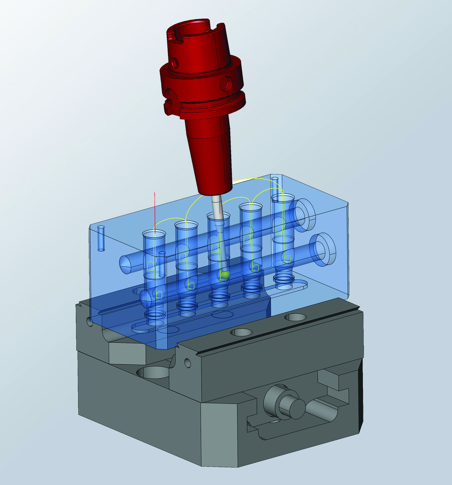

A new, fast, easy, and safe 5-axis hole deburring strategy excels at deburring sharp edges on holes and intersecting holes. By using CAM Plan programming assistance and analysis technology to automatically recognize all the holes, the sharp edges in the model are marked for selecting the desired edges. The hole deburring technology automatically calculates toolpaths, and supports 3-axis and 5-axis modes.
DeburringTop: Linking with hyperMILL Dynamic Stock technology. Above: 5-axis Hole Deburring with hyperMILL 2025.“>

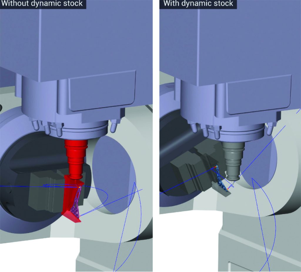

Linking movements via hyperMILL VIRTUAL Machining Optimizer have been further optimized for actual stock conditions with new Dynamic Stock technology. Using Dynamic Stock, an updated stock is automatically generated for all machining jobs and accounted for when calculating linking movements.
