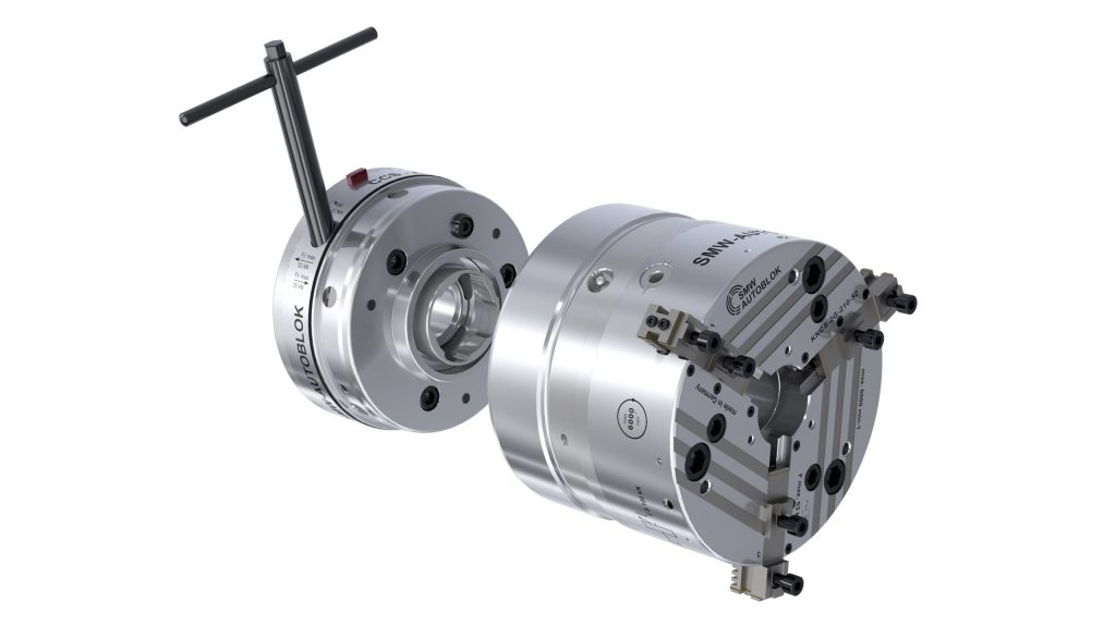

Providing excellent repeatability that is guaranteed within 10 microns, the CCS can be installed in under three minutes on new or existing lathes that saves time and increases operator productivity. A standard adapter system provides automatic push off and easy mounting to all types of traditional or custom workholding including 2-jaw chucks, 3-jaw chucks, collet chucks, mandrels, and manual fixtures, among others.

SMW Autoblok, a world leader in the design and manufacture of rotational chucks, stationary workholding, tooling and custom engineered solutions for the machine tool industry, introduces the innovative CCS chuck changing system.
With a simple turn of a key, quickly connect workholding devices to the machine spindle and draw tube of the actuating cylinder. This guarantees operator safety in addition to minimizing machine downtime. A large through hole and a visual safety control of the locking status completes the versatility of the CCS chuck switching system.
