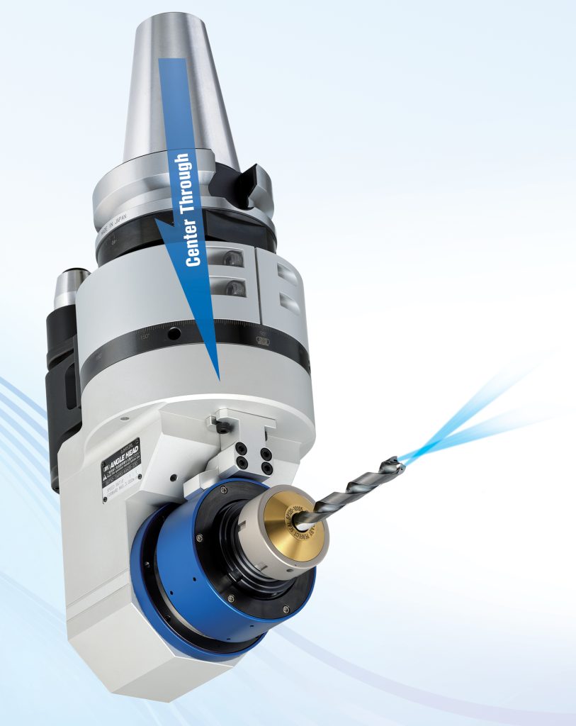

The TAG90 center-through-coolant angle head and AG35 high-pressure coolant adapters from Big Daishowa deliver coolant directly from the machine spindle to the cutting edge, bypassing the stop block, which enhances cooling efficiency and chip removal. The new angle heads support coolant pressures up to 1,000 PSI.
August 5, 2025
The TAG90 center-through-coolant angle head and AG35 high-pressure coolant adapters from Big Daishowa are the newest additions to its fixed 90-degree angle head lineup.
These center-through-coolant angle heads deliver coolant directly from the machine spindle to the cutting edge, bypassing the stop block, which enhances cooling efficiency and chip removal. The new angle heads support coolant pressures up to 1,000 PSI.
Customers can choose between the Build-Up type angle head, which allows users to change the adapter for use in various machining applications, or the HMC type angle head—a high-rigidity milling chuck. The Build-Up type angle head leverages AG35 high-pressure coolant adapters, including the New Baby Chuck and Side Lock adapter types.
Big Daishowa’s angle head lineup allows shops to combine vertical and horizontal operations on one machine, and to access hard-to-reach features on a workpiece that would otherwise be impossible without multiple setups. This can reduce cycle times while also improving overall accuracy and eliminating the potential for error created by multiple setups.
