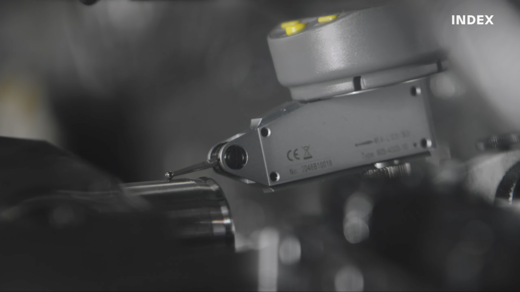

With CenterMaster, the user simply clamps a radio dial gauge into the workspace and sets it to the quill. The gauge and machine wirelessly communicate, automatically adjusting the holder along the X axis. The system then guides the operator through adjusting the Y axis via the machine's touchscreen display.
January 14, 2023
INDEX has announced the launch of its new CenterMaster accessory. As part of the company’s sustained investment in R&D focused on streamlining the setup and changeover process for CNC multi-spindle lathes, CenterMaster reduces the time needed to align a drill by up to 90%.
Previously, center alignment of a drill required specialized knowledge by the operator and a challenging, manual process that could take up to 30 minutes per holder. With CenterMaster, the user simply clamps a radio dial gauge into the workspace and sets it to the quill. The gauge and machine wirelessly communicate, automatically adjusting the holder along the X axis. The system then guides the operator through adjusting the Y axis via the machine’s touchscreen display.
The CenterMaster system allows operators with no specialized knowledge or experience to set up a drill in 2-3 minutes. Additionally, it provides a repeatable accuracy of <5μm.
