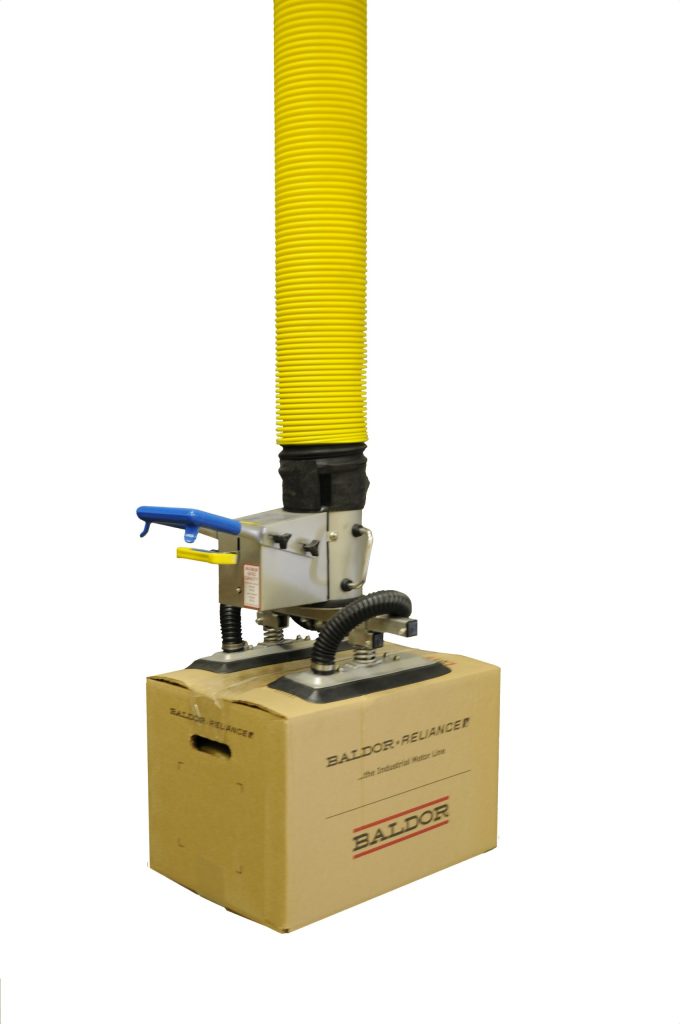

UNIMOVE LLC presents its CM500 vacuum tube lifter for safe and ergonomic handling of bags, boxes, pails, drums, sheet rock and more. A robust pulley-driven power unit, operated at up to 5,000 rpm, provides a high lifting capacity and the ability to effectively handle both porous and nonporous materials.
August 5, 2019
A 5″-dia. copolymer RHINO Tube lasts significantly longer than traditional lifting tubes. When coupled with standard stainless-steel components, these proven products provide years of trouble-free service. With a capacity of 140 pounds (nonporous, 110 pounds porous), automatic balance control, and the ability to accommodate six to 10 moves per minute, the CM500 is suitable for in-plant material handling, warehouse lifting and production line work.
The RHINO Tube copolymer construction lasts up to six times longer than traditional lift tube designs, with no skewing. This versatile material withstands up to a million flexes, has an operating range of -40° F to 240° F, and is totally inert to chemical attack, which makes it ideal for washdown environments.
