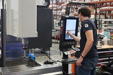

The 770MX CNC mill from Tormach offers more power, faster motion and multiple operator-focused improvements that was designed for shops and teams that need high performance in a compact footprint. The mill features a series of enhancements intended to reduce cycle times, improve ease of use and support consistent, repeatable machining performance across a wide range of applications.
The new 770MX features an absolute encoder EtherCAT servo motion system and an EtherCAT-based control platform for the spindle and axes, supporting faster, more responsive motion and integrated feedback. The machine also includes increased spindle capability, with 2 hp continuous power and 4.5 hp peak intermittent power, while still running on single-phase power.

Motion performance has also been improved, with maximum feed rates of 450 IPM in X and Y and 420 IPM in Z. The 770MX maintains a compact working envelope of 14” (X) x 7.5” (Y) x 13.25” (Z), delivering serious machining capability in a footprint that fits more shops, labs and workspaces.
The upgraded 770MX includes a 21.5” PathPilot touchscreen operator console as standard, along with built-in load meters for the spindle and axes. Additional refinements include an integrated air gun on the front of the enclosure, improved side-loading windows, a door latch included by default and mounting locations for tool holder racks and Wall Control-compatible storage solutions.
The 770MX is available in two default configurations: a factory-assembled option that includes an automatic tool changer and flood coolant system, and a self-assembled option that ships in components for on-site assembly.
