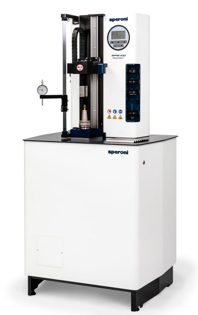

The new Speroni Pro Shrink TubeChiller 1100 from Big Daishowa. The combination shrink and cooling system automatically cools down tool holders immediately after heating to reduce burn risk to operators.
The company said that with this standalone unit, the heat-shrinking process is easy. First, the high-frequency coil heats up the tool holder. Once the heating is done, the tool cooling process is automatic, with the body of the chiller cooling down the tool uniformly.
Other key highlights include:
- The pyrometer constantly measures the tool holder's temperature to avoid overheating
- The heating action is maintained when the ideal temperature is reached, so overheating the tool holder is impossible
- Start the shrinking process with one touch: Browse the menu and choose the parameters through the simple and intuitive display screen
- Shrinking and cooling processes are totally customizable
- The shrinking range is Ø 3 - 32 mm for carbide shanks and Ø 6 - 32 mm for HSS shanks
