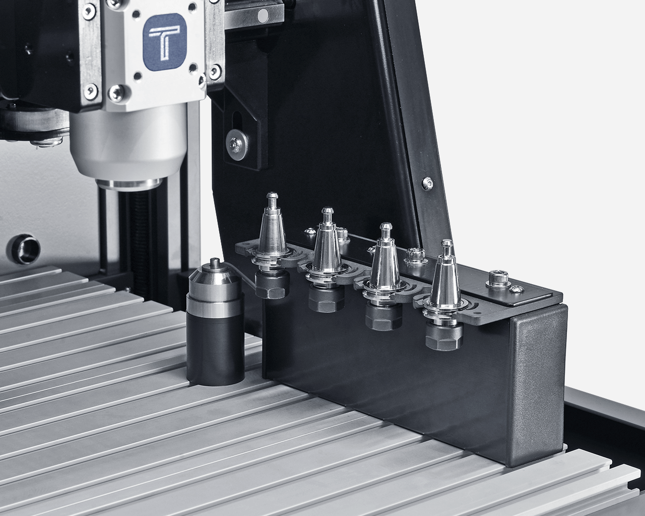

Automatic tool changerThe xsTECH Pro version introduces a 4-station automatic tool changer (ATC), expanded spindle capabilities, and optional robotic workcell integration.“>
The xsTECH Pro introduces a 4-station automatic tool changer (ATC), expanded spindle capabilities and optional robotic workcell integration. These upgrades let students experience real-world machining processes without the complexity or cost of industrial-scale equipment.
