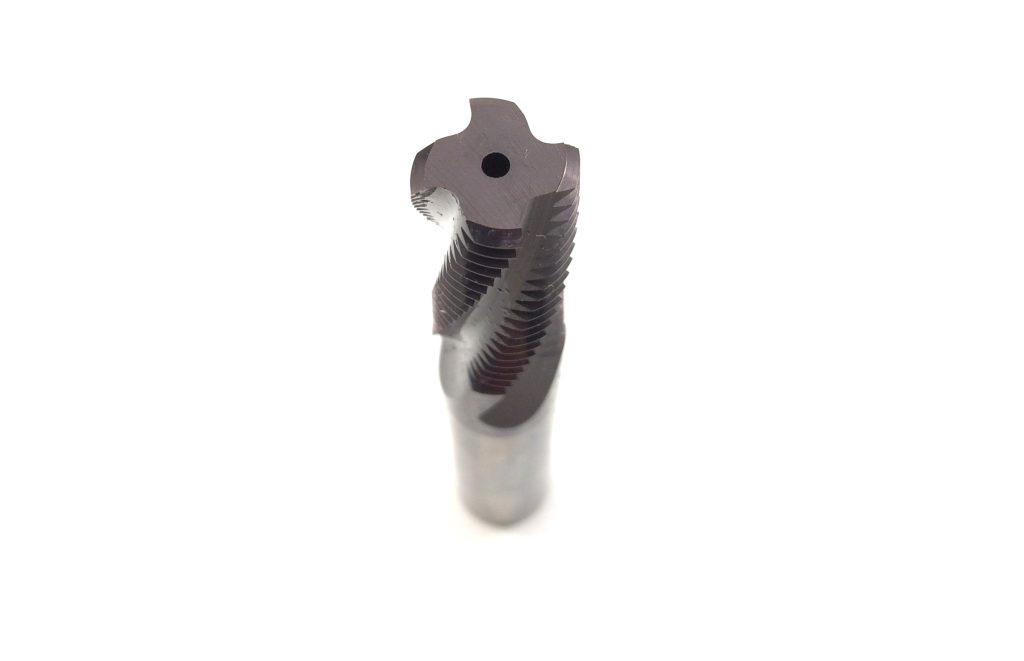

Allied Machine & Engineering Corp. offers a complete range of coolant-through thread mills that are ideal for blind-hole applications. Allied's coolant-through threadmills significantly improve chip evacuation when threading blind-holes, according to the company.
March 23, 2016
Allied Machine & Engineering Corp. offers a complete range of coolant-through thread mills that are ideal for blind-hole applications. Allied’s coolant-through threadmills significantly improve chip evacuation when threading blind-holes, according to the company. They reduce tool deflection and provide straighter and more precise thread forms. End users will also achieve longer tool life and experience less tool breakage due to chip build up.
Offered in both inch-shank and metric-shank options, inventory is available for all carried items. Fast delivery times are guaranteed, with same-day shipping on inventoried items. There are more than 100 different items available, including a variety of threadforms, diameters and lengths, with new coolant through thread mill options being added regularly.
Allied’s coolant-through threadmills, ideal for numerous applications in the mold and die, oil and gas, aerospace, and automotive industries, are a versatile solution for producing screw threads. They are perfect for materials that generate heat, especially high-temperature alloys, high-strength alloys and stainless steel used in aerospace and oil and gas applications. Unlike taps, threadmills can produce a variety of thread diameters as well as right- or left-hand threads.
The new Allied design features a thick core geometry, which maximizes the coolant hole size through the center. The increased core diameter strengthens the tool and allows more coolant flow-through, resulting in faster flushing and better cutting edge cooling.
Allied supports threadmill customers with a large team of field sales engineers all over the globe. This technical support team can help set up the tool, ensure it is running correctly, and troubleshoot any problems that may arise. Also available free of charge is an online thread mill programming tool, available 24/7, which prepares the G-code program to run the thread mill based on the specific application parameters.
