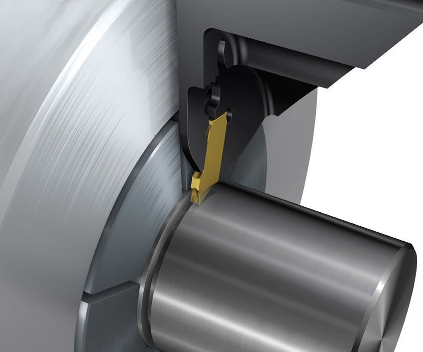

Considered a “hidden machining cost,” component material waste is an often-overlooked production expense. Wider insert blades cut more material than necessary during each parting off operation with the excess material ending up in the chip bin. Using a thinner insert blade not only wastes less material but also allows for more parts per bar when parting off using a bar feeder. Realizing this material savings is especially important for those who machine components made of expensive materials, such as heat-resistant super alloys like Inconel, titanium and cobalt chrome. When working with these high-priced materials in higher volumes, using a thicker insert blade can be costly.
For smaller insert widths, insert handling is easily accomplished with the use of the insert cam key. Accompanied with each CoroCut QD, the cam key allows the user to leave the finger of the blade in the open position allowing for use of both hands for insert positioning. With the turn of the cam key, the new insert clamp design offers improved rigidity for process security. CoroCut QD toolholders are made using the same improved tool steel as the larger width CoroCut QD, resulting in 12 percent higher tensile strength.
According to Staffan Lundström, Parting and Grooving Product Specialist at Sandvik Coromant, “As the only product currently on the market that offers over and under coolant in a tool this thin, the CoroCut QD inserts in 0.04 inch, 0.05 inch and 0.06 inch work well for deeper cuts and larger diameters and for all materials, especially HRSAs.” Parting and Grooving Specialist Scott Lewis adds, “Shops that solely focus on tool costs can be missing the big picture. When a tool costs you more in material waste over time, especially expensive materials, the overall cost to machine a component can be much higher than expected.”
