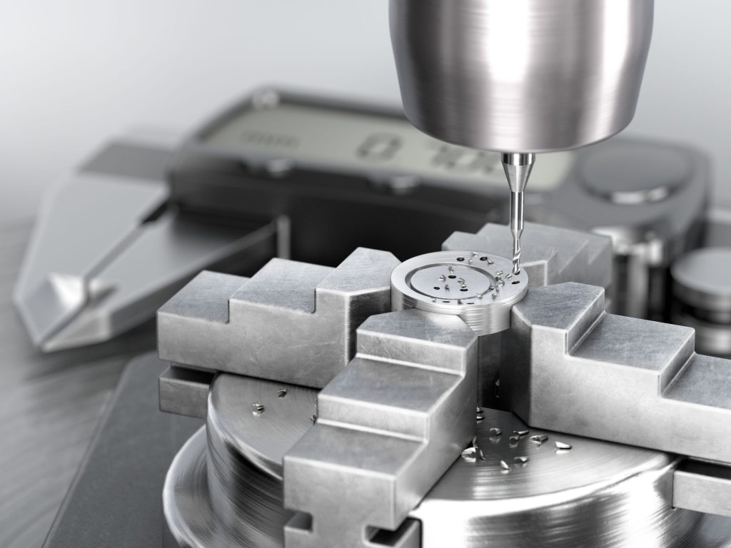

Sandvik Coromant, a global leader in machining solutions, has launched two new microdrill families specifically designed for precision machining. The CoroDrill® 462 with -XM geometry and the CoroDrill® 862 with -GM geometry support industries with high demand for small part manufacturing, including medical, automotive, electronics and aerospace. Designed to cover a variety of workpiece materials, the new drills offer precise performance where accuracy is key.

The drills have been specially adapted to overcome the challenges of micro drilling. For instance, much like macroscale applications, it’s critical to have quality coolant to effectively evacuate chips when performing deep-hole drilling with micro tools. Both the CoroDrill® 462 and 862 can easily drill hole depths of up to nine times diameter (xD) when using external coolant, and a through-coolant option is also available for drilling diameters of 1.00 mm and above, and hole depths of up to 16xD. Not only does the effective use of coolant help the tools to drill deeper holes; it also extends the tool life and reduces the risk of chip jamming.
Individually, the CoroDrill® 462 offers high performance hole making up to 3.00 mm. Ideal for drilling both blind and through holes, the drill is capable of machining a variety of ISO materials, including ISO P, M, K, N, S, O and H. With a drill depth of 6xD, the CoroDrill® 462 offers manufacturers a versatile drilling solution.
The CoroDrill® 862 is ideal for making holes from 1.00 mm to 3.00 mm in diameter in all materials, when used with internal coolant. In addition to conventional drilling, the CoroDrill® 862 supports a variety of other drilling activities, including cross holes, stack drilling and drilling of convex and concave surfaces.
The CoroDrill® 462 and 862 are available as both off-the-shelf and customizable solid carbide tools. As part of the range, Sandvik Coromant has made it possible to configure the tools based on diameters, usable length, step-diameter length and shank diameter, for manufacturers who require a bespoke approach to micro drilling.
Customers also have the option of purchasing the CoroDrill® 862 with a polycrystalline diamond (PCD) vein cutting edge. PCD is up to 100 times more wear-resistant than solid carbide. In addition, PCD tooling is more accurate and can produce tighter tolerances than solid carbide tools. Therefore, customers seeking to drill micro-sized holes in notoriously difficult-to-machine materials, such as titanium, aluminum, glass and ceramics, should consider PCD.
