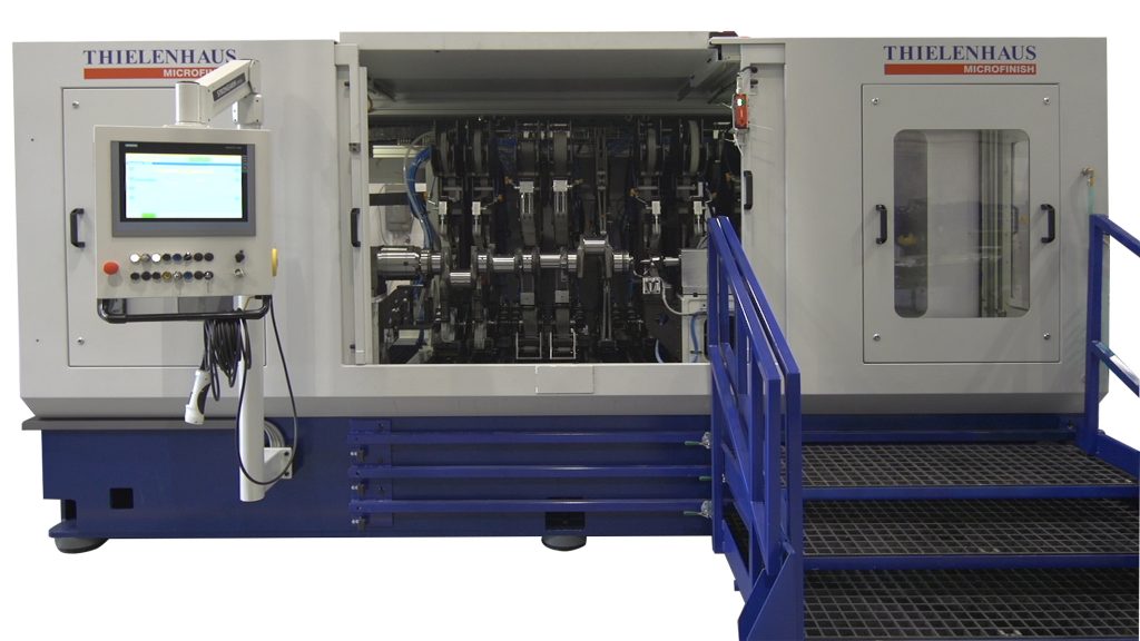

The shoe systems can all be integrated in Thielenhaus's CrankStar machine platform, which features horizontal and vertical versions for machining passenger car or truck crankshafts and can be adjusted to the specific needs of each manufacturer. Based on his requirements regarding part handling, cycle times, quality tolerances, part variations and machining tasks, Thielenhaus can develop a machine concept that is precisely tailored to the needs of the customer.
In order to achieve the same roundness improvements on main- and pin bearings, the CrankStar employs pneumatic technology to counterbalance pin bearing forces of +/- 5 Newton. This ensures that the machining forces on the rotating crank pin are kept constant and that the mass forces that occur between the shoe and bearing are compensated. The roundness is thus improved to exactly the same extent on all bearings, whether pin or main bearings.
In the standard version, the CrankStar is capable of machining crankshafts for engines with three to six cylinders, in some cases even without major retooling. In addition to centre and pin bearings and thrust faces, the CrankStar can finish oil seal diameters and deburr bores in the flange. Thrust face machining occurs via a special unit while the workpiece is oscillated. Even with vertical machine concepts, the CrankStar comes with up to 33 percent longer intervals between tool changes than the industry standard, featuring a tape capacity of 300+ metres. The vertical solution allows a quick belt change from the front of the machine, without requiring the withdrawal of an entire tool carrier package.
