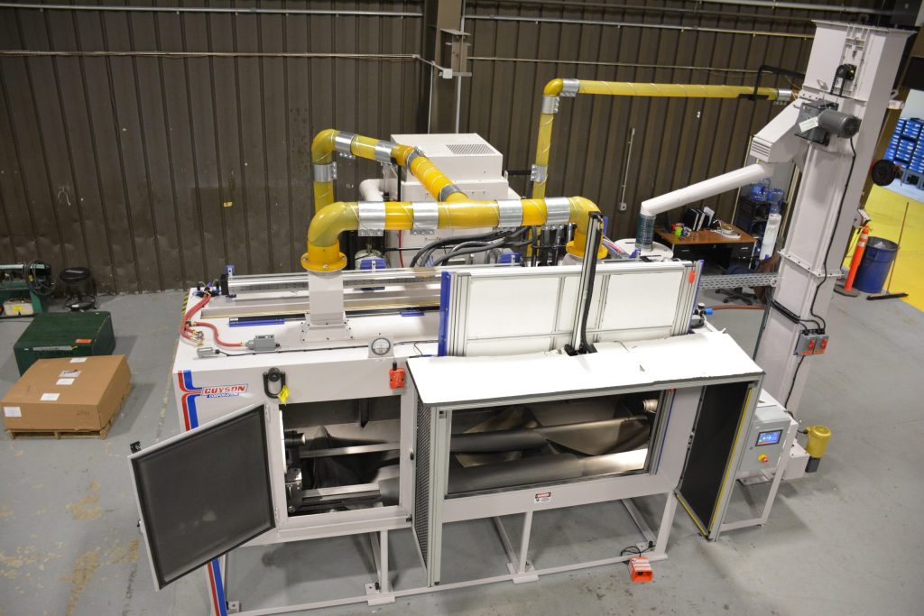

Guyson just completed a custom grab bar peening machine for the commercial restroom industry. The cabinet was equipped with 100" linear actuator with encoder to blast parts up to 105". The part enters the cabinet and is rotated at high velocity while (4) pressure nozzles blast the part to create a selective etch.
May 3, 2017
Guyson just completed a custom grab bar peening machine for the commercial restroom industry. The cabinet was equipped with 100″ linear actuator with encoder to blast parts up to 105″. The part enters the cabinet and is rotated at high velocity while (4) pressure nozzles blast the part to create a selective etch.
The reclaim is equipped with a 300/28 cyclone separator with 6.5 cubic foot pressure media delivery. The cyclone reclamator provides media separation, consent downward flow of shop air ensuring good visibility and reduces the possibility of particle contamination. To balance the reclaim and ensure negative pressure in the finishing enclosure aD-2000 dust collection system was selected.
