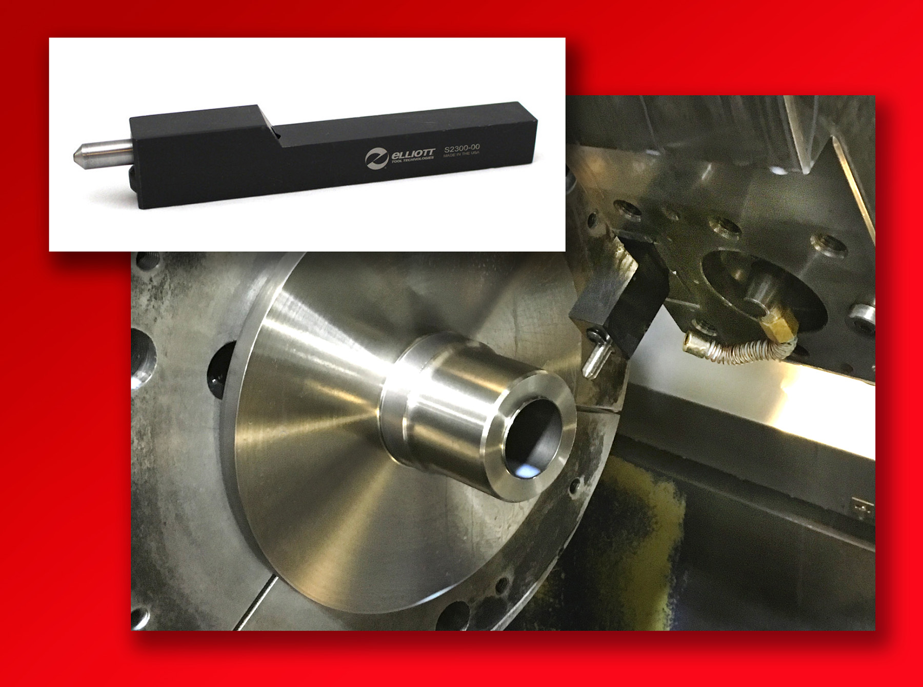

Diamond burnishing is ideal for a variety of parts and ductile metals under 40 HRC, including steel, stainless steel, aluminum and cast iron. A cast iron shaft which started at a preburnished 67 Ra microinch surface finish yielded a 10 Ra microinch finish with a 0.0005" material compression in a single pass at 750 sfm.
February 26, 2016
Diamond Burnishing Tools by Elliott Tool Technology produce an ultrasmooth, mirror-like surface finish on linear surfaces in a single pass. This cost-effective, easy-to-use tooling from Monaghan Tooling Group improves surface irregularities and tool marks, producing optimum surface finishes of 4-8 Ra. This proven technique can eliminate secondary processes such as grinding, honing and polishing by automating those processes in the primary CNC machine. Doing so saves setup and processing time and labor costs and also enhances machinery utilization and shop floor productivity.
Diamond burnishing is ideal for a variety of parts and ductile metals under 40 HRC, including steel, stainless steel, aluminum and cast iron. A cast iron shaft which started at a preburnished 67 Ra microinch surface finish yielded a 10 Ra microinch finish with a 0.0005″ material compression in a single pass at 750 sfm. This was particularly helpful as the abrasive material was wearing inserts rapidly and attaining the desired part print was proving difficult.
Elliott diamond tools increase the surface hardness through the cold working process and compressive forces, and increase metal’s resistance to fatigue and failure at stress points while producing a dense and uniform surface. They are available in inch and metric slim-line, square, offset, on-center, stick and boring bar styles.
With cycle times that are measured in seconds rather than minutes, diamond burnishing allows companies to achieve a consistent mirror-like finish and replace hand polishing. Economical, long-lasting and replaceable wear parts reduce the total cost over the life of the tool. Wear parts are easy to replace, with common tooling available from stock. Their operation and maintenance requires minimal training.
