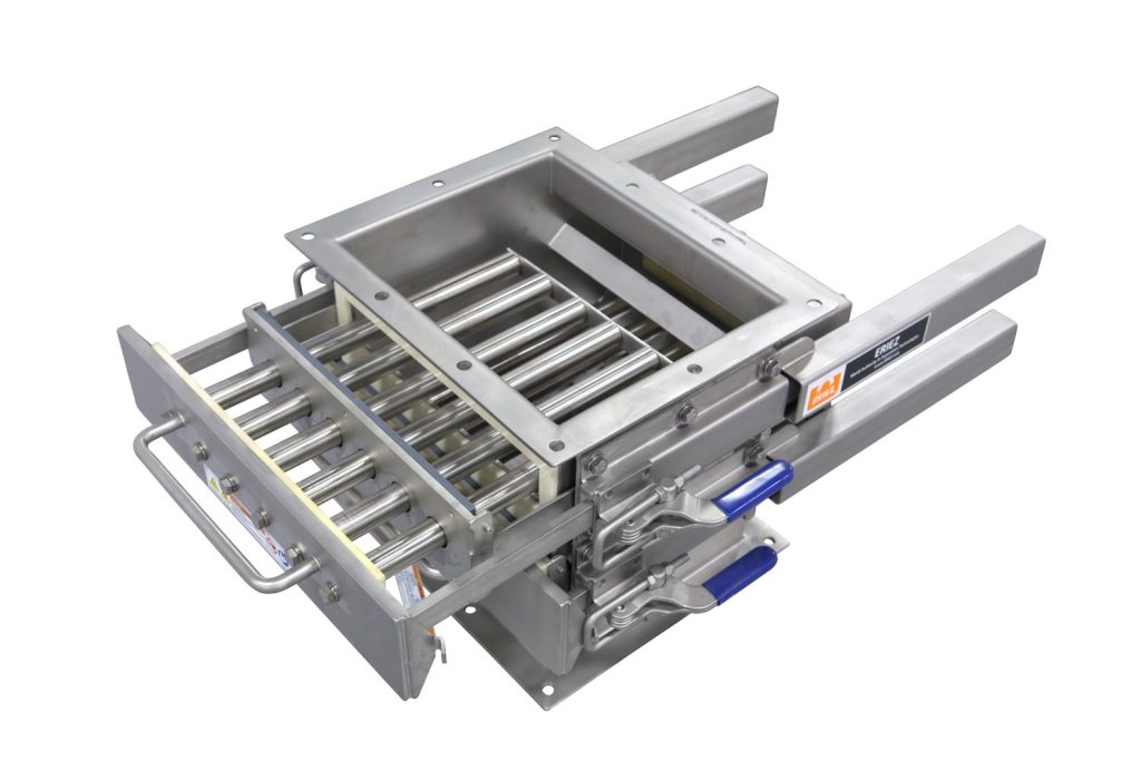

Eriez introduces a new magnetic separation technology with the Easy to Clean DSC (Dust-tight, Sanitary, Convertible) Grate in Housing Magnet. According to Eriez, dust-tight construction was its central focus when developing this magnet.
Eriezintroduces a new magnetic separation technology with the Easy to Clean DSC (Dust-tight, Sanitary, Convertible) Grate in Housing Magnet. According to Eriez, dust-tight construction was its central focus when developing this magnet.
"The DSC handles fine powders better and some head velocity pressure while maintaining a positive seal," says Eric Confer, separation product manager. He adds, "It delivers a solution for customers who want easy cleaning features, but cannot have any spillage or leaking on their process floor."
The standard housing on this new magnet is sanitary on the interior. Eriez also provides customized options to meet customers' specific needs, including sanitary-welded tie bars.
Confer explains, "We designed the new Easy to Clean DSC Grate in Housing Magnet primarily for two groups of customers: those who find they're cleaning their magnet more frequently than expected due to heavy contamination removal and those who simply are not cleaning their magnet enough and need to improve that frequency."
This separator's innovative design allows customers to purchase a manual clean unit that can later be easily upgraded to an automatic cleaning unit with simple hand tools and a bolt-on kit.
The new Easy to Clean DSC Grate in Housing Magnet combines a state-of-the-art design with a powerful Eriez Xtreme RE7 magnet circuit. According to the results from performance testing conducted by Penn State, the Eriez Xtreme RE7 tube circuit is significantly stronger than any other magnet on the market today. Eriez' magnet was also among the best performers in terms of magnetic flux density.
