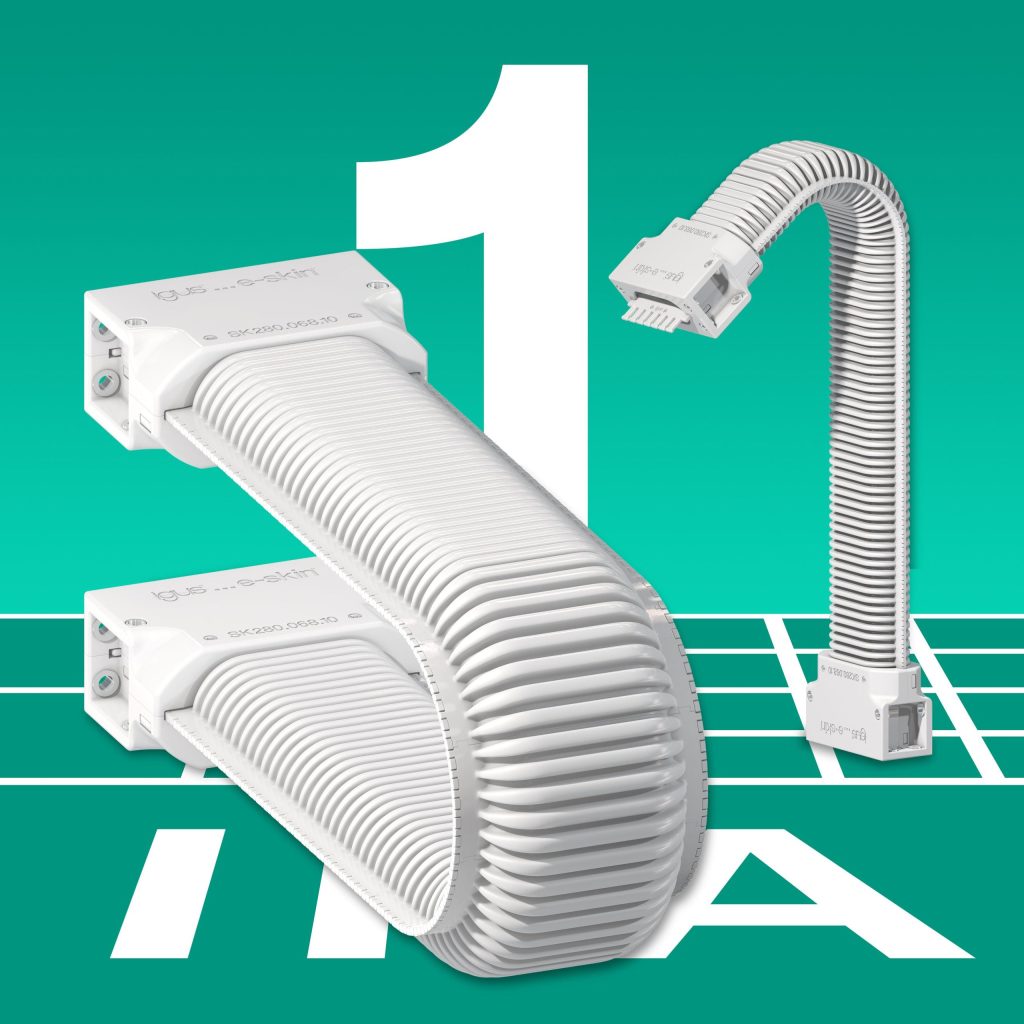

In many industries, such as medical and pharmaceutical technology and production, contamination and air purity is absolutely essential. Any contamination can have a damaging impact on products and processes, and incur a range of costs and loss of profits.
June 16, 2016
In many industries, such as medical and pharmaceutical technology and production, contamination and air purity is absolutely essential. Any contamination can have a damaging impact on products and processes, and incur a range of costs and loss of profits. The e-skin corrugated tube from igus is now available for use to provide a safe, high-strength and flexible energy supply system without generating airborne particles which can contaminate the environment.
The design and material of the e-skin were the major factors in the acquisition of the IPS ISO Class 1 certification, through the Fraunhofer Institute. The corrugated tube is comprised of tribologically optimized, abrasion resistant plastic “shells,” which can easily be joined with a zipper type mechanism to form a fully enclosed tube, which is highly resistant to dust, water, and other materials. This simultaneously provides the cleanroom-approved operation and quick installation and long-term protection of cables and hoses.
The easy-to-assemble e-skin is lightweight, with a stiff design and defined direction of motion, making it ideal for small spaces and short unsupported distances. Interior separation is also available for increased protection of cables and hoses.
