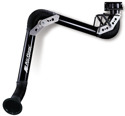

The Airflow Systems E-Z Arm High Flow series of contaminant extractors provides powerful, and efficient operation. Capable of handling air flow rates up to 1,500 CFM, the E-Z Arm extractor design delivers an energy consumption level of only 0.35 KW/hr at 800 CFM; 73 percent below a more typical level of 1.30 KW/hr at 800 CFM. The high-capacity air flow volume, along with the low energy consumption level of the E-Z Arm extractor is made possible by the Airflow Systems patented pawl-and-sprocket, friction-release, external arm support system. The E-Z Arm extractor’s external support design eliminates the internal supports, common with other systems, that obstruct the internal air flow path, reduce collection efficiency, and increase energy consumption. The friction-release design of the E-Z Arm extractor simplifies operator use by eliminating resistance when moved away from gravity, and engaging positively when moved to a stationary position. Operators no longer wrestle with extractor arms falling out of position, or drooping hoses interfering with visibility or work surface accessibility.
The Airflow Systems E-Z Arm High Flow contaminant extractor arm has a large, 6.75-inch diameter; and is available in lengths of 7, 10, and 14 feet. For process-critical applications where sanitary or corrosion-resistant construction is necessary, the E-Z Arm extractor is available in 26-gauge stainless steel, with food-grade, UL rated hose and HDPE seals, collars, and fittings.
