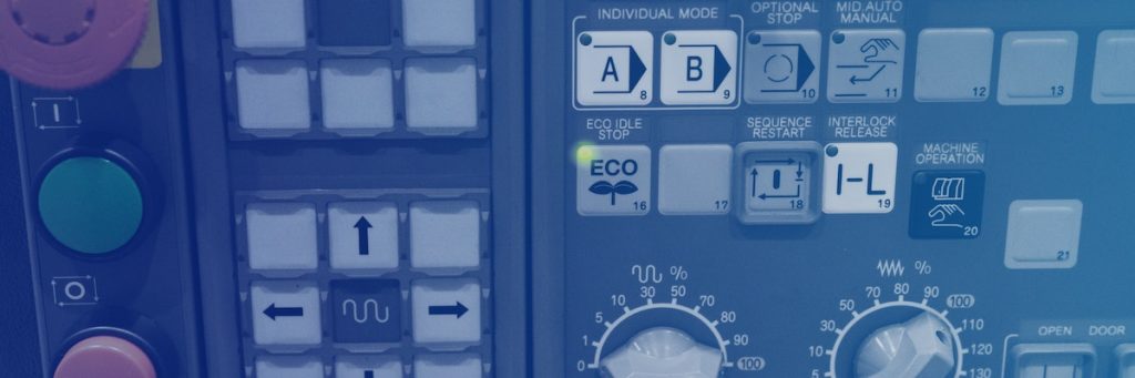

  • ECO Idling Stop: The application’s ECO Idling Stop function monitors the cooling stays of the milling and turning spindles. It will automatically turn off the coolers for those spindles when spindle temperature is stable.
  • ECO Power Monitor: The ECO Power Monitor feature displays the power consumption of various components directly on the machine tool’s display. This includes the power consumption of spindles, feed axes and peripheral equipment, giving the operator a view of the total energy being saved at a glance, without requiring a data export or separate smart device.
  • Additional Optional Features
    • ECO Hydraulics - utilizing SERVO technology, actively monitors the demand of hydraulics to activate the hydraulic pump only as necessary to maintain pressures as called
    • ECO Operation is recommending to users with multiple peripherals, as this function will run peripheral equipment only when needed and turn off peripherals once machining is complete
