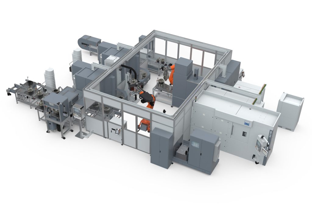

Cleaning, Pressing, Welding and Checking in a Single Line
A perfectly timed sequence becomes apparent for truck differentials, it consists of three individual parts before production starts: two housing parts and the ring gear. These each weigh up to 130 kilos (287 lbs) and have a diameter of up to 600 millimeters (24 in). The detailed sequence is as follows:
· After being fed by two separate loading stations, the two housing parts and the ring gear run through an EMAG laser cleaning system—a new in-house development that already looks and feels like a standard machine. The process is extremely fast and removes all residues, such as coolants or preservatives, using a focused laser beam.
· Robots then remove the parts from the laser cleaning machines. The ring gear is first preheated with induction heating and is then transported to the joining station (preheating is performed using a low-frequency generator by EMAG eldec). The two halves of the housing are directly fed into the joining station and press-fitted together with the ring gear. The process is performed under force/path monitoring.
· The subassembly is now ready for welding—a robot loads it into the EMAG ELC 600. After axial clamping, the housing is closed, and the ring gear is joined with the housing using two welds.
· An EMAG ultrasonic testing system automatically checks the quality of the welded joint —a key step in the process that is just as important to specialists as is the machining of the workpiece.
Within 12 months, the development of this process was completed! The specialists at EMAG LaserTec had to overcome a number of process-related challenges during this time—after all, the weld seams are cast steel/case-hardened steel connections with great depth, which are welded with an 8 kW (11 hp) solid-state laser and with welding additives. Aside from that, the dimensions of the manufacturing system are impressive: The whole system consists of two laser cleaning stations, a heating station, a joining station, the ELC 600, and the ultrasonic testing station, which are interlinked with complex feeding technology and two industrial robots.
