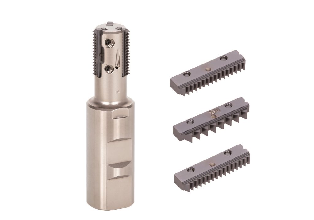

Tungaloy is introducing the ETTL model for ThreadMilling, an indexable thread milling tool series for efficient thread milling operations.
August 31, 2019
ThreadMilling incorporates cost-effective, double-sided inserts with two cutting edges. The tool allows efficient and precision production of various standard threads, such as ISO metric threads, Unified threads, and Whitworth parallel pipe threads, on modern CNC milling machines and machining centers, using helical interpolation programs. ThreadMilling provides a high level of security thanks to the light cutting load generated when the tool breaks the chip in smaller pieces, preventing chip from being jammed, which typically occurs during tapping.
New ETTL are available in tool diameters, ranging from 17 mm to 30 mm with flute counts of 2, 3 and 5. The insert clamping screws are embedded in the tool body so that the screws will not come loose when exchanging the inserts, eliminating the concerns of dismantling or losing the screws. In addition, the clamping force of the insert screws are enhanced over that of the existing ETLN style, allowing higher feed rates to be applied with improved cutting performance. Customers can continue to use the same CNC programs that are being used for the existing ETLN style.
At a Glance:
Able to thread mill ISO metric threads, Unified threads, and Whitworth parallel pipe threads
Double-sided insert with two cutting edges
Embedded insert clamping screws to facilitate insert exchanges, which prevents from losing the screws
Higher insert clamping design allows applications of high feed rates for improved cutting performance
Same CNC programs can be used as with ETLN-style ThreadMilling
Nine cutter bodies and nine inserts to be introduced
