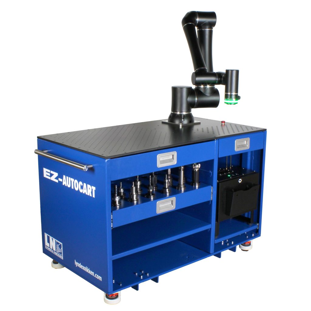

The EZ-AutoCart, part of Lyndex-Nikken's EZ-Automation product line, easily automates CNC machine tending of CNC lathes, mills, and similar machines. The EZ-AutoCart machine tending solution enables machine shops to streamline machine tending with minimal effort; no-code automation empowers manufacturers to easily operate the EZ-AutoCart. Results include significantly boosting spindle time and enhancing overall machine efficiency.

The EZ-AutoCart, part of Lyndex-Nikken’s EZ-Automation product line, easily automates CNC machine tending of CNC lathes, mills, and similar machines. The EZ-AutoCart machine tending solution enables machine shops to streamline machine tending with minimal effort; no-code automation empowers manufacturers to easily operate the EZ-AutoCart. Results include significantly boosting spindle time and enhancing overall machine efficiency.
The EZ-AutoCart integration capabilities:
  • Includes 16 digital I/O to control peripheral devices
  • Manage auto doors open/close
  • Manage workholding open/close
  • Optional hub provides data mining and quick change between multiple CNC machines
  • Monitor CNC machine conditions
The EZ-AutoCart vision capabilities:
  • Includes integrated camera for 2/3D vision
  • Optional software for 2.5D picking
The EZ-AutoCart boasts a payload capacity of 18kg, reach of 1300mm, maximum joint speed of 435°/s, and repeatability of +/-0.025mm. Additionally, options available include workholding, end-of-arm tooling, infeed grid plates, safety scanners, and integration support.
