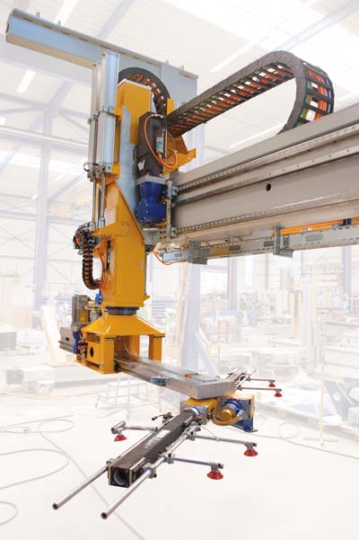

With the FEEDERplus6, STROTHMANN has proved that a transfer system which unloads, orients, and feeds parts into presses all by itself can work more efficiently than double feeders or articulated arm robots, especially in small press gaps.
December 1, 2010
With the FEEDERplus6, STROTHMANN has proved that a transfer system which unloads, orients, and feeds parts into presses all by itself can work more efficiently than double feeders or articulated arm robots, especially in small press gaps. The handling system with six linear and rotating axes is exceptionally fast and flexible. It processes up to twelve large parts per minute with a repeatability of +/-1.5mm.
The FEEDERplus6 is programmed like a standard robot. The feeder allows for a better synchronization of modern, computer-controlled presses and is also suitable for retrofitting old presses. The two models have standard load capacities of 80 or 125 kg including the tooling and can be installed in small press gaps with a minimum distance of 5,500 or 6,500mm between press tables. STROTHMANN’s FEEDERplus6 and FEEDERplus8, which are employed in combination in many applications, form the new dream team in press automation,. The precise and dependable technology ensures that press lines can be operated at maximum speed.
