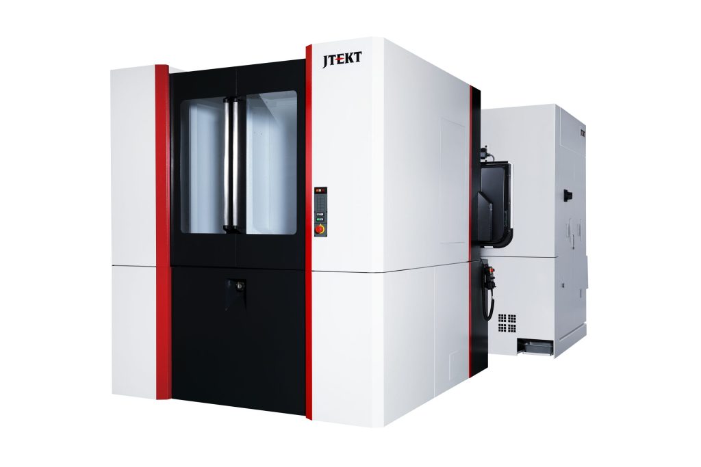

JTEKT Toyoda Americas Corporation has recently introduced its FH5000 series of three high-speed horizontal machining centers (HMC), including the FH5000S HMC with 800X800X880 mm (X, Y, Z) strokes, 900mm workpiece diameter, and 1100mm workpiece height capacity. The FH5000 series machines include a 500mm table capable of handling 1000 kg loads.
"With this series, Toyoda meets the growing demand for producing components with high metal removal rates, short cycle times and superior surface finishes," said a company spokesperson.
Toyoda's FH5000S HMCs with 60-tool ATC capacity are designed for speed and production reliability, featuring a 15,000 RPM, 50 HP (37 kW), 303 Nm (223 ft-lbs.) high acceleration spindle. The 40-taper spindle is designed with four ceramic bearings at the front of the spindle for increased rigidity and reduced vibration. Its patented hydraulic preload system brings the spindle up to 15,000 RPM less than one second without spindle warm-up, ideal for aluminum processing. The larger machines in the FH5000 series are equipped with a 50-taper spindle, 45 tools, and a longer X axis travel.
This machine is equipped with a direct drive B-axis table featuring an index time (90°) of 0.7 seconds. The FH5000 machining centers with the spindle design, preload system and high torque features, allows machine shops to take advantage of more aggressive, high-volume machining in a compact footprint, according to the company.
Easily programmed, the H5000 series features the TOYOPUC-Touch panel through which the operator can monitor the machine, see operating data including energy consumption, and edit as required.
