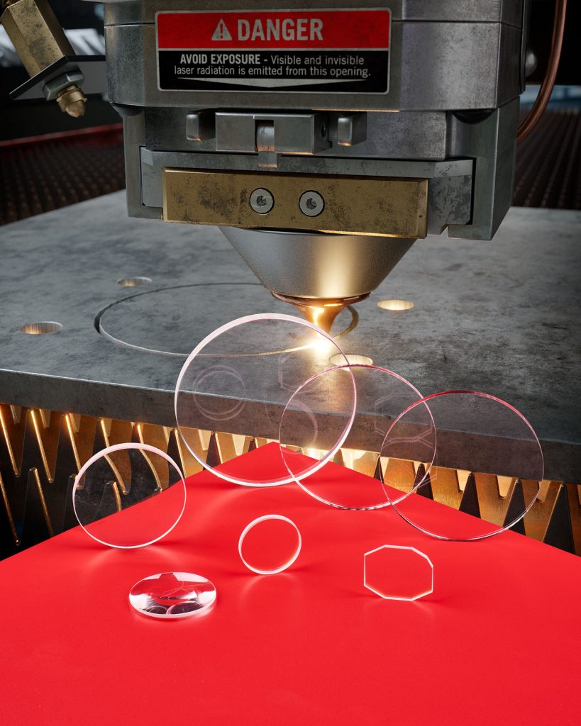

LRO Fiber Fused Silica Lenses are offered in 1″ and 2″ sizes with 5″ to 10″ focal lengths and can be self-installed by the user. Eliminating the need for major laser head disassembly and delays associated with returning the laser head to the manufacturer for lens replacement, these 1 micron lenses are coated at 1.06 microns on both sides for lasers up to 10 kW.
Providing a light protective edge bevel on both edges, LRO fiber fused silica Lenses have 1 fringe max. surface accuracy at 633 nm within clear aperture on both faces. Surface quality on both faces is 10-5 scratch-dig per MIL-PRF-13830. These fused silica lenses have an anti-reflective coating for less than 0.25 percent reflectance per surface at 1.080 microns.
