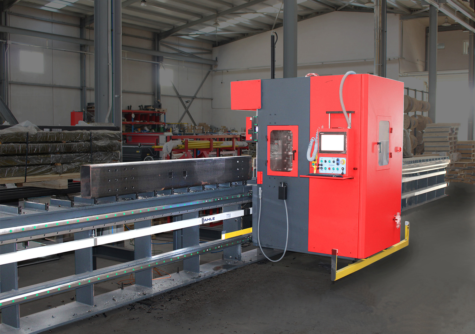

FlexCNC introduces the Beam Line – the latest addition to its lineup of machining centers for large or long parts, like structural steel beam, in a single setup. With an open-bed design that measures 40-feet by 2-feet, this new model can machine parts up to 40 feet in length.
Alternately, the long open bed, coupled with the movable safety light curtain, allows multiple setups, so that while the FlexBEAM is machining one part, another can be loaded (or offloaded). This dramatically increases productivity of the machine's uptime. The open design provides unrestricted access which makes loading and unloading easier and faster. In addition to structural steel beams, FlexBEAM machines are suitable for the machining long products like tube or pipe and cutting keyways.
The FlexBEAM has a monoblock welded steel frame with high rigidity and a T-slot machine bed. It features 3-axis interpolation, scribing, automatic hydraulic workholding and automatic tool touch-off. In addition, a laser zero detector is standard, as is 6 x ATC, a hand pendant, and network with ethernet cable. All of these standard features are available at a list price of $149,995. Delivery, installation, training and two-year warranty are available for $9,500.
Standard unit runs on 480V and includes mobile light-curtain safety barriers, frame with chip conveyor and T-slotted table, flood coolant pump and tank, and automatic tool calibrator. The 12" color touch screen is water-resistant and durable enough to provide years of service. Oversized double hung precision linear guideways ensure smooth and precise movement on all axes. All moving parts are self-lubricating on all axes. A programmable servomotor drives the spindle, while a 10-compartment toolchanger/" data-glossary-id="142091" data-glossary-teaser="Mechanism typically included in a machining center that, on the appropriate command, removes one cutting tool from the spindle nose and replaces it with another. The changer restor…" title="Mechanism typically included in a machining center that, on the appropriate command, removes one cutting tool from the spindle nose and replaces it with another. The changer restor…" aria-label="Glossary: automatic toolchanger">automatic toolchanger ensures capacity for virtually any application.
Control on the FlexBEAM is simple yet powerful, with conversational and ISO G- and M-code programming for versatile 3-axis CNC machining along with an optional 4th axis. Equipped with a color touch screen control, 40 GB of program storage and 50 programmable zero points. Programs can be loaded through USB or through and Ethernet connection. Extensive training is provided, both in-plant and on-site.
