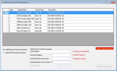

FASConnect was designed to address the needs of factories of any size as it is scalable from 2 to 22 simultaneous users, from 10 to unlimited CNC connections and multiple "servers" are possible. HSSB support for older CNCs is also possible (dedicated PC needed in this case). FASConnect is a software only solution that installs as a Windows service on a central computer. This computer becomes the "server" and once configured it allows access to all the FANUC CNC systems that are on the plant network.
FANUC CNC systems going back to the late 1990s are capable of Ethernet communication to the plant network and older FANUC CNC systems can utilize FANUC HSSB fiber optic communication. FASConnect can communicate with all of these systems going back to about 1994. This allows for a single solution for almost 2 decades of FANUC CNC controls. FASConnect is the Server side of a Client/Server type application. So, the main application is installed on a central PC and then accessed either locally on that central server PC or remotely from a client PC that can be located elsewhere on the same network.
FASConnect uses the common File Transfer Protocol (FTP) for a high degree of compatibility. The connected CNCs can then be accessed as if they were folders on a computer both locally from the computer in which software was installed on and remotely from computers throughout the network. No client software is required as FASConnect uses the standard Windows Explorer as the client. Up to 22 simultaneous users can connect using standard the Windows Explorer built into the PC. With FASConnect the CNC data is presented in a folder/file structure in Windows Explorer. This is the same easy format that any PC users will recognize. The CNC data files can be dragged and dropped for backup, and the files themselves can be opened with any text editor and are easily readable. Since FASConnect software installs as a service in Windows, it can be run without a user login or desktop interaction that may allow a user to accidentally terminate the software.
Built-in security allows for only backing up of the critical CNC data. Writing of part programs to the CNC is possible as long as the user has the correct credentials (username/password). This reduces the risk of CNC data being compromised but allows for remote part program management by the programmer, without going down to the machine. The FASConnect service will run on Windows XP, Windows 7 or Windows Server 2008. Clients can be any Windows based computer.
