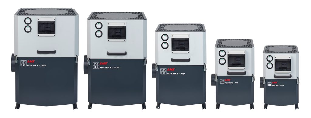

The Fox WS 2 Series oil/coolant mist collectors from LNS America Inc. efficiently and reliably remove oil/coolant mist, smoke and other fine aerosols and particulates from CNC machines to provide a healthier workplace, reduce absenteeism and lower HVAC costs. The five models with capacities from 170 to 1,250 CFM, enable users to properly match all machine sizes, types and processes that use water-soluble, synthetic or neat oil coolants, with or without high pressure delivery systems.
June 27, 2016
All models exceed OSHA and NIOSH clean air requirements, have a patented, 3-stage filtration system that guarantees optimum filter life, and accept an optional 4th-stage modular HEPA filter for applications that warrant removal of 99.97% cutting oil smoke particles and other fine aerosols and particulates. The long-life filters can be easily replaced in just 15 minutes.
Recent enhancements include a redesigned, V-shaped floor that makes it easier to drain accumulated liquids and keeps them away from the pre-filter, thus extending its life and new, dual air pressure gauges that monitor pre- and final filters so users can maintain peak airflow at all times.
Installation is now easier and more versatile with a suction inlet port that can be mounted either left or right to accommodate all machines and fit within tight spaces. There are also new mounting stands available, including a 28" tall stand on wheels and a 6' tall vertical stand.
