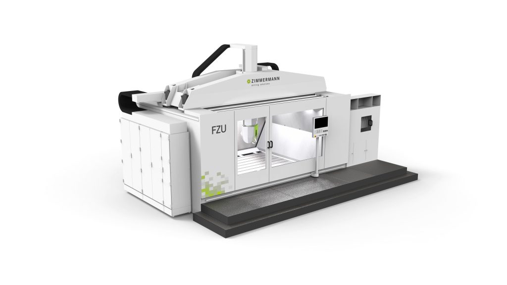

Its focus is on aluminum cutting, but steel can also be machined. This enables Zimmermann to offer customers a very efficient, flexible and space-saving machine, while the corresponding design improvements have also had an effect on the price. “The requirement we were presented was for an entry-level model which rounds off our program at the lower price point,” explains Gänzle. The result is the FZU, a 5-axis gantry milling machine, which is optimized for weight and stability.
In contrast to the established FZ33 and other machines that Zimmermann offers, the company is taking a different path with the FZU. “We can narrow down the special features of this gantry machine to three main characteristics,” describes Gänzle. The first point: “We are following the trend towards modern manufacturing machines and designing them as space-saving, pre-assembled units.” This means Zimmermann assembles the machines in-house and can then transport them to the customer by truck or ship without having to dismantle them. Onsite, they are ready for use in a very short commissioning time; erection and start-up require minimum effort. For the customer, this means quickly available machines which can be installed without constructing foundations. “In the design, we have kept to the usual transport sizes. At the same time, the new FZU achieves a remarkable working range for its size,” explains Gänzle.
It is important to match the machine to the required dynamics. Adverse environmental conditions and long machine running times necessarily give rise to thermal expansion effects. In spite of the customers’ increased accuracy requirements, the machine must always achieve outstanding surface finishes. The Zimmermann engineers have therefore designed the FZU gantry machine to be thermo-symmetrical. This means that the milling spindle, guides and other accuracy-determining components are arranged so that their heating is either compensated or they can expand in uncritical directions. “This is the second important characteristic,” emphasizes Gänzle. The base frame consists of a steel welded construction which forms a continuous U-shape. The machine gantry’s centrally guided Z-slide has an octagonal section – and not a rectangular one like comparable machines – which makes it particularly stable. Thanks to its design, it therefore has impressive rigidity for its size. “With a weight of approximately 35 tons, a length of 3,500mm, width of 7,500mm and a height of just under 5,000 mm, we have been able to build a light and compact machine,” says Gänzle.
The third characteristic relates to the new VH10 milling head, which achieves an extremely high power density. “This new development has enabled us to reassess our portfolio,” reports Gänzle. This is because the VH10 head will replace the VH12, which is not a Zimmermann product. Alongside the VH20, VH30 and VH60, the VH10 is now the smallest head in the range. Users will also benefit from the fact that Zimmermann has suitable spare heads in stock and can supply them on request in the event of stoppages, for example, due to a crash. “We strive to respond quickly and provide the customer with optimum support,” emphasizes Gänzle.
Thanks to its slender design, the VH10 spindle head has only minimal interference contours. Compared to the VH12, it achieves almost double the clamping force. This is due to the fact that Zimmermann fits two side cheeks instead of one onto the unit. The VH10 is therefore considerably more stable in operation. In order to minimize throughput times, a powerful 34 kW spindle with a maximum speed of 24,000 rpm is used in the milling head as standard. “The FZU is therefore ideally suitable for the materials typically found in this business sector, such as Ureol, clay and aluminum. In the future, we will also use the new milling head in larger machines on which processers can produce one-to-one models – for example, on our FZ37,” says Gänzle.
To provide a high-quality machine at an attractive price, the designers at Zimmermann have turned their attention to remaining competitive with regard to price through increased component standardization, while at the same time addressing individual customer requirements. As with all machines produced, Zimmermann therefore also relies on a modular system with the FZU. Among other things, this approach enables different size variants and power levels to be produced. There are also numerous equipment options, which offer the customer maximum flexibility.
Zimmermann is therefore able to provide a very efficient solution with the new FZU. It is often the little things that give rise to success and customer satisfaction. “We place great importance on details – an aspect which cannot always be measured in the numbers,” explains Gänzle, who cites two examples: “For instance, the machining area is fully clad with stainless steel sheets in order to guarantee maximum resistance to abrasion. The FZU is also the first gantry milling machine to be equipped with our innovative, new NXP 24-inch multitouch controller, which is already used on our FZH horizontal machining center.” Another increasingly important topic is ergonomics. The door is divided asymmetrically to enable components to be easily fed to the machine. A small, easy-to-open door leads into the machining area, while the large door is used for loading. Operators therefore have a relatively large field of view, rapid access to the machining area and ample space for loading – ergonomic advantages which are not to be underestimated. Another detail is that a cabinet has been installed directly in front of the FZU. “This was the idea of one of our designers,” says Gänzle. “The tables, which users in the various plants position in front of the machines to place their accessories and service tools, caught his attention. With our solution, everything which is part of day-to-day operations can be safely stowed close at hand within the machine.” Added to this, there are extraction equipment and special chip management systems. “It is often the simple ideas which make the machine operator’s everyday tasks much easier,” sums up Gänzle.
