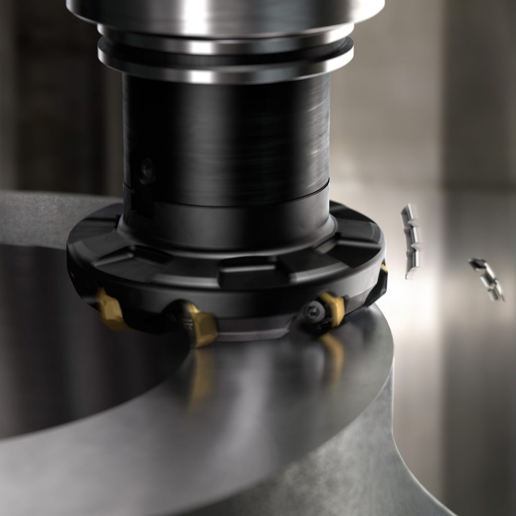

Manufacturers face many challenges when milling ISO P workpieces. For instance, some hard and abrasive steels can generate wear along the flank face of the insert, especially at higher speeds and with a longer time in cut. Additionally, machining in unstable conditions because of compromised clamping or long overhang elevates the risk of insert chipping, while thermal fluctuation during machining, especially under wet conditions, can cause crack formation and subsequent sudden breakages.
“Our new grades overcome these issues in many ways,” states Magnus Engdahl, product application manager at Sandvik Coromant. “For instance, the optimized Inveio coating increases wear resistance and tool life dramatically, without jeopardizing security. With its unidirectional crystal orientation, the coating has a high resistance to thermal cracks, which in turn promotes long and reliable tool life, a factor further supported by a new post-treatment process that strengthens the insert by modifying its mechanical properties.”
A newly developed substrate provides well-controlled grain size distribution, which results in more reliable and predictable tool behavior. Additionally, consistent tool life is supported with higher narrow edge-rounding (ER) tolerance. Increased tool life will deliver reduced cost per component, while improved process security brings predictable performance and less downtime, not to mention higher component quality.
GC4330 is a medium hard grade and is for roughing to semifinish facemilling, with the tough GC4340 grade for rough shoulder milling and groove milling. Wet and dry machining is supported, although dry machining is recommended.
Both GC4330 and GC4340 are available in the following product families: CoroMill 390 and CoroMill 490 for shoulder milling; CoroMill 345 and CoroMill 745 for facemilling; CoroMill 210 for high-feed milling; CoroMill 200 for profile milling; and CoroMill 331 for grooving and parting off. Although the grades are optimized for steel, they are also suitable for mixed production involving ISO K (cast iron) and ISO M (stainless steel) workpieces.
