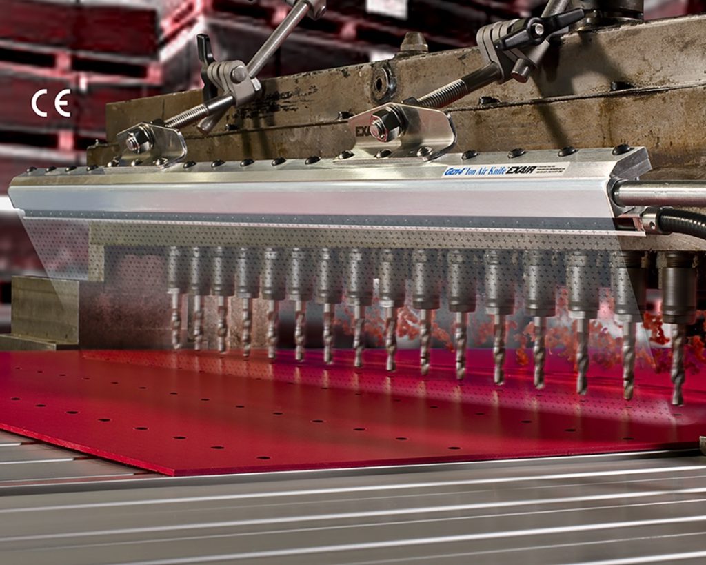

Gen4 products have undergone independent laboratory tests to certify they meet the rigorous safety, health and environmental standards of the U.S., European Union and Canada that are required to attain the CE and UL marks. They are also RoHS compliant. New design features include a metal armored high voltage cable to protect against abrasion and cuts, integrated ground connection and electromagnetic shielding.
The Gen4 Standard Ion Air Knife incorporates EXAIR’s Standard Air Knife that minimizes compressed air use by inducing surrounding airflow at a ratio of 30:1. The unique amplified airflow carries the ions to the target, making it possible to eliminate static charges in less than a half second. Air volume and velocity are infinitely controllable from a “breeze” to a “blast” to gently wipe or forcefully blow away debris.
EXAIR’s Gen4 Standard Ion Air Knife product line is available from stock in 3″ to 48″ long. The electrical ion source is shockless and there is no radioactive element. A new selectable voltage power supply has been designed to operate Gen4 products.
