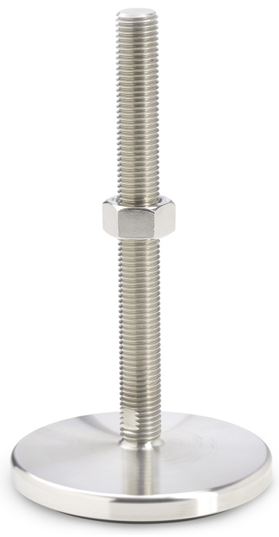

J.W. Winco Inc. announced it offers GN 21 stainless steel leveling feet with a turned base, without lag bolt holes, in metric sizes.
These RoHS-compliant leveling feet have a base of stainless steel, European Standard No. 1.4301 (American Standard Series 304). The threaded stud is of stainless steel, European Standard No. 1.4305 (American Standard Series 303). ISO 4032 Hex nut is stainless steel, European Standard No. 1.4305 (American Standard Series 303), and is a standard part of the assembly.
The following stud types are available: without locknut, with external hexagon below; with locknut, with external hexagon below; without locknut, with flat width below; with locknut, with flat width below; without locknut, with flat width below, internal hexagon above; with locknut, with flat width below, internal hexagon above; without locknut, with flat width below, external hexagon above; with locknut, with flat width below, external hexagon above; with adjustable sleeve; and tapped hex sleeve type. All types can be ordered with or without inlaid non-skid pad of Perbunan (NBR), 70 Shore A, black. Also available are GN 23 versions, which have lag bolt holes to affix the foot to the surface upon which it is being mounted.
