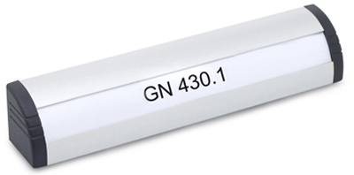

J.W. Winco Inc. offers series GN 430.1 ledge handles with lettering block, in metric sizes.
J.W. Winco Inc. offers series GN 430.1 ledge handles with lettering block, in metric sizes. Typical applications for these RoHS-compliant ledge handles include swivel or sliding doors on protective doors and equipment. They are also suitable for use as drawer handles.
Mounting is accomplished by means of a screw channel where multiple screws can be fastened to secure the handle. The screw channel for screw size M6 (extruded aluminum) allows an optimal number of fixing screws in any position within the dimensions l2. A minimum screw-in depth of 10mm must be maintained.
Handle is aluminum, natural color anodized finish or plastic coated in black textured finish. End caps are technopolymer plastic (Polyamide PA), dark gray. When delivered, the end cap is mounted on one side so that the supplied paper/film strip can be lettered and pushed into the provided groove of the handle. The lettering block is manufactured of a bright white, age-resistant paper strip and transparent PVH hard film. Available upon request: aluminum profile sections in any length, individual end caps, single paper/film strips.
