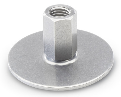

J.W. Winco Inc. offers GN 440.5 Stainless Steel Leveling Feet with Tapped Socket, Plain, with Elastomer Base Cap or Vulcanized Rubber Pad, in inch and metric sizes.
September 1, 2014
J.W. Winco Inc. offers GN 440.5 Stainless Steel Leveling Feet with Tapped Socket, Plain, with Elastomer Base Cap or Vulcanized Rubber Pad, in inch and metric sizes. These RoHS-compliant leveling feet are simple, economically priced components. They will bear static loads from 7 to 16 kN. Base diameters from 40 to 80mm (1.57 to 3.15 inches) are available.
Leveling feet have a tapped socket of stainless steel, European standard No. 1.4301 (American Standard Series 304), shot-blast finish. The assembly screw is of stainless steel A2, loctited in place. The optional plastic base cap is made of a black thermoplastic elastomer (TPE) with 80 Shore A hardness. The optional vulcanized non-skid pad is black Nitrile Butadiene rubber, with 70 (+/-) 5 Shore A hardness.
