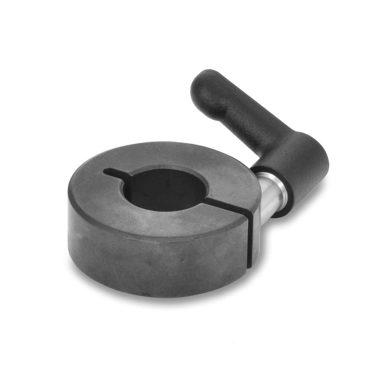

J.W. Winco Inc. offers GN 706.4 steel, aluminum or stainless steel split set collars in metric sizes with adjustable hand levers for tool-less clamping. The split set collars can safely and simply be assembled with high clamping forces via the adjustable lever without damaging the surface of the shaft the collar is being mounted on.
December 20, 2016
J.W. Winco Inc. offers GN 706.4 steel, aluminum or stainless steel split set collars in metric sizes with adjustable hand levers for tool-less clamping. The split set collars can safely and simply be assembled with high clamping forces via the adjustable lever without damaging the surface of the shaft the collar is being mounted on. With a shaft tolerance that should be within h11, these RoHS compliant set collars not only serve as an end stop, but they can also be used for fixing or triggering other components such as end limit switches.
Also available in stainless steel and aluminum, the steel version body is made from sintered steel with black oxide finish. The handle of the adjustable hand lever is zinc die-cast, with a black electrostatically applied powder coat finish, and the insert and screw are stainless steel.
